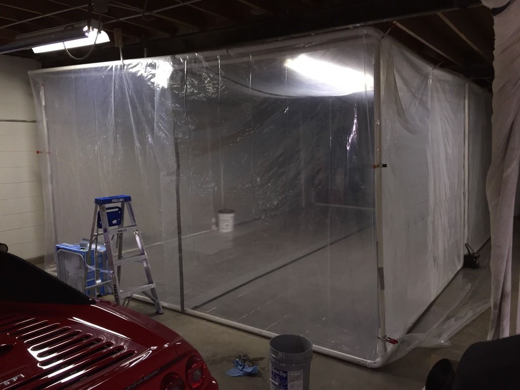

For the past month we have been busy insulating a building where we recently started a custom car business, so we haven't moved the '68 any closer to paint, but hope to this month (November).  I put together a modular homemade paint booth (14 ft x 24 ft) so we are ready when the car is ready.
I'll move some additional lights in when we paint.

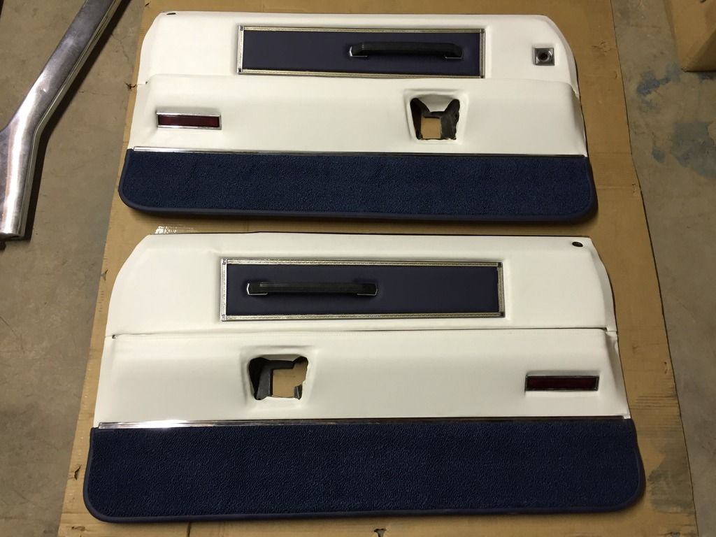

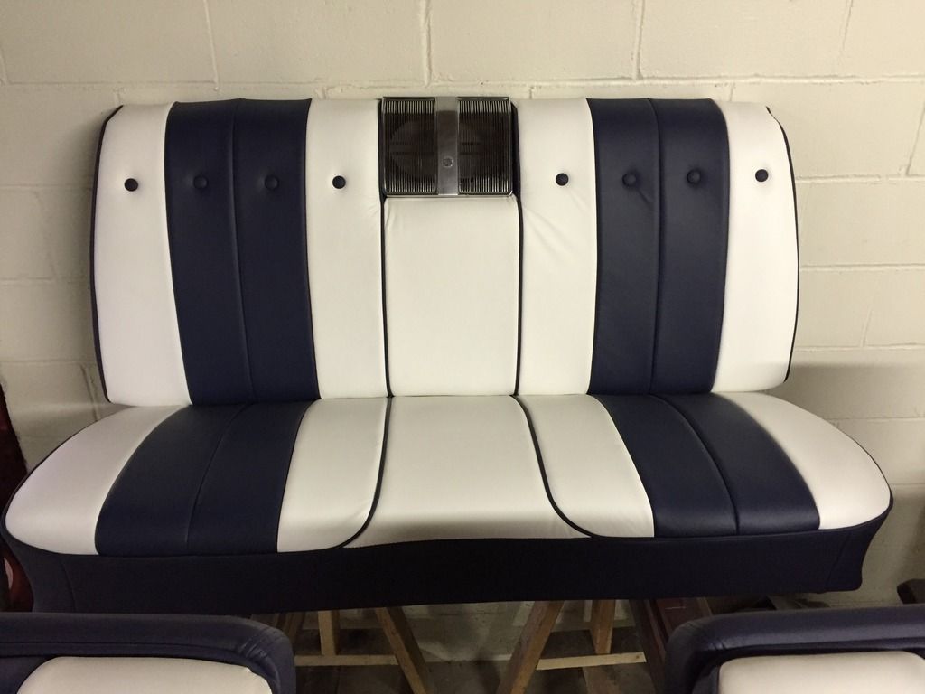

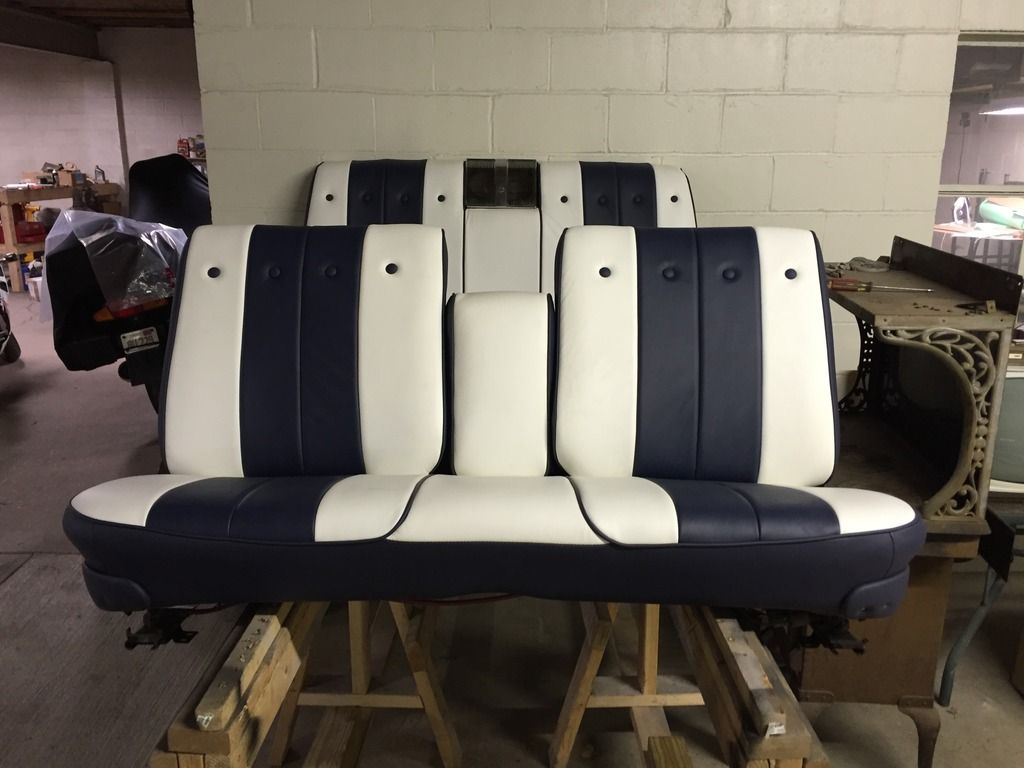

Even though the bodywork hasn't progressed, I did get the custom interior this month.

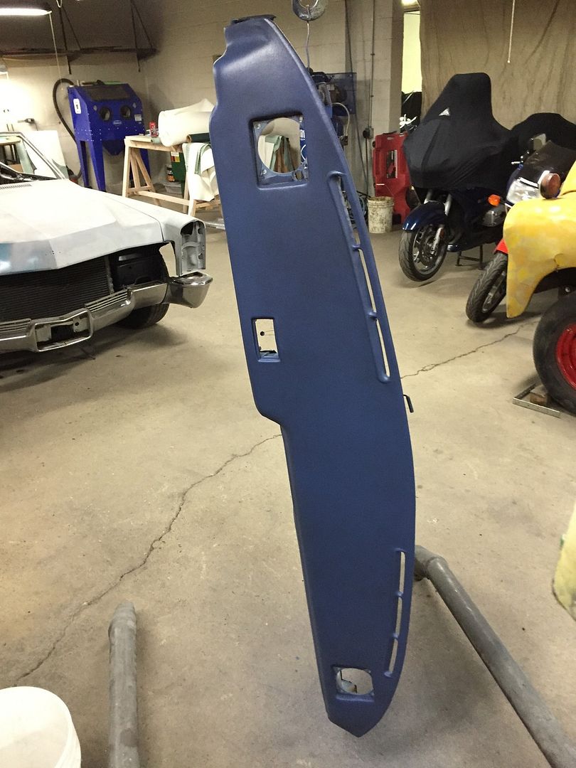

And this week I changed the color of the dashpad from black to blue.
