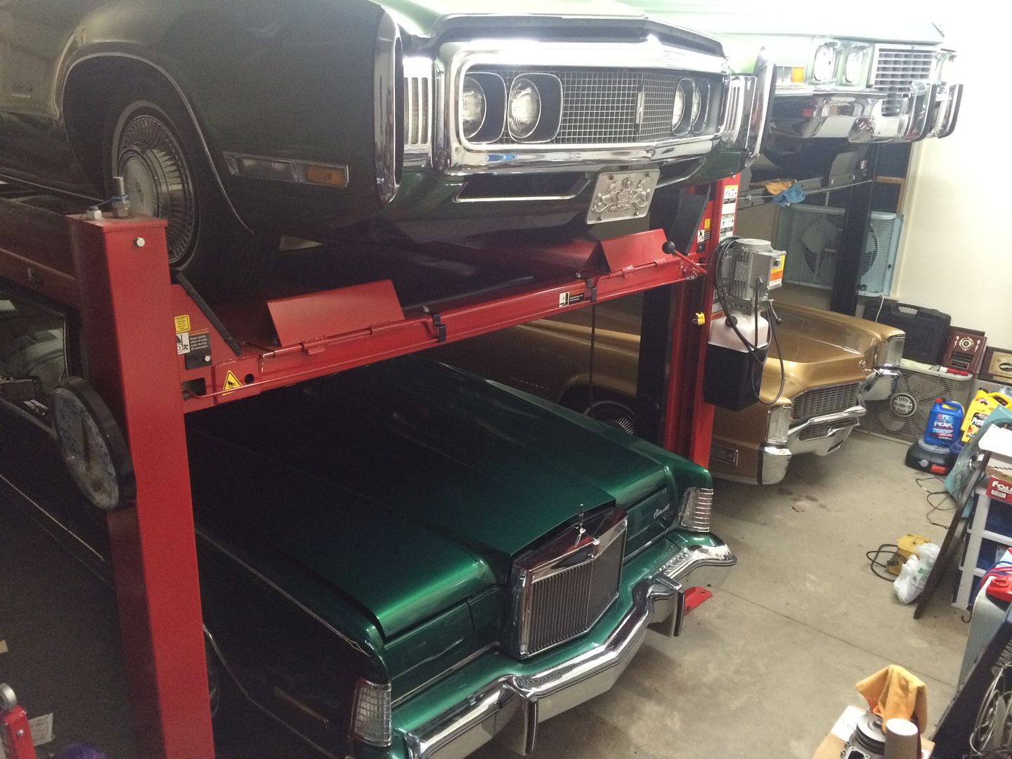

CaddyShackPA
#29
Speaking of floor strength... I hope mine is adequate:
If not we will have a sinking feeling.
