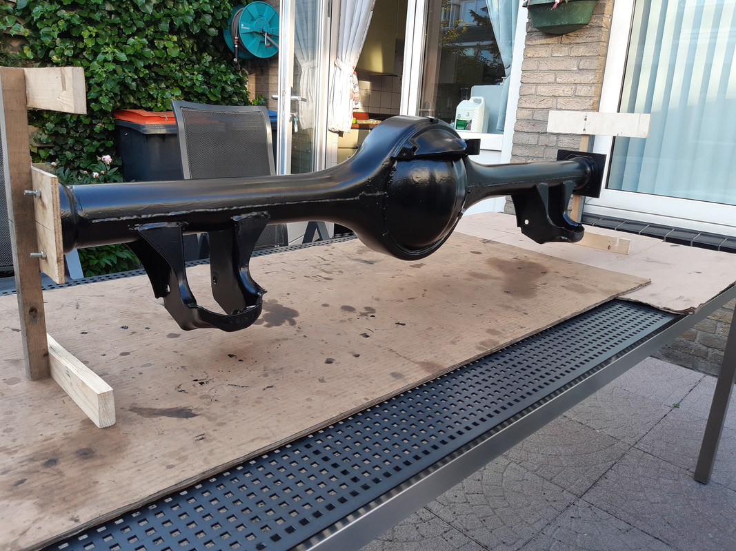

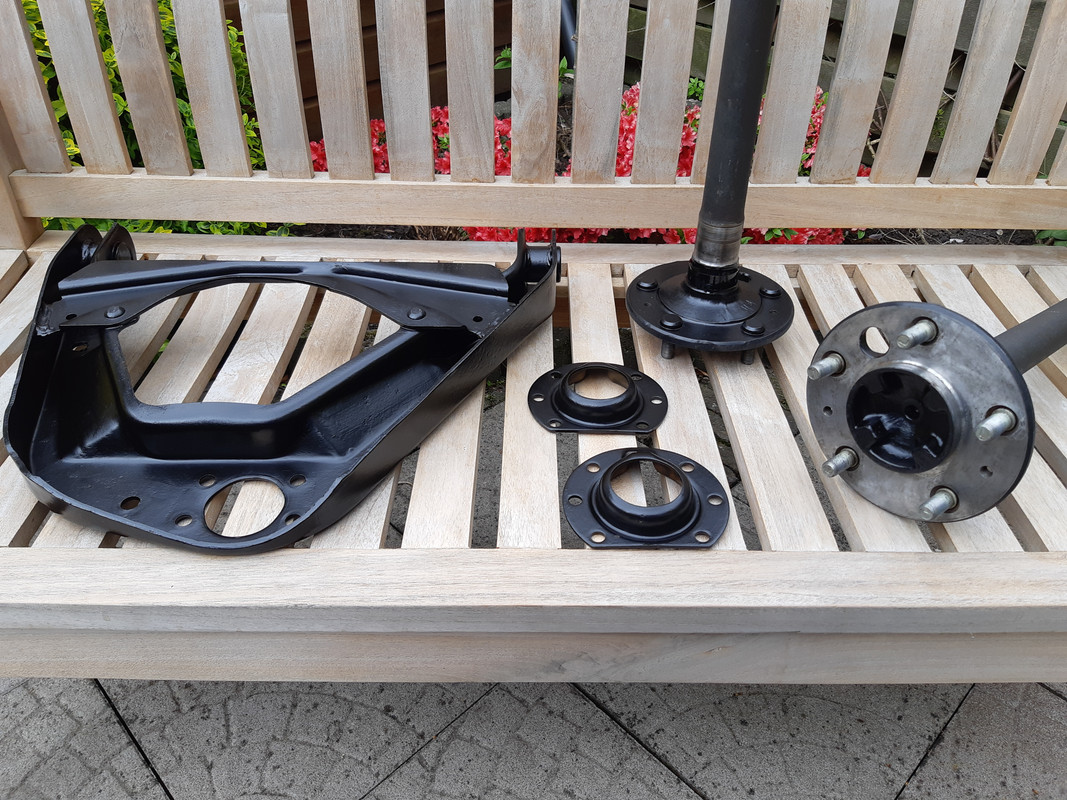

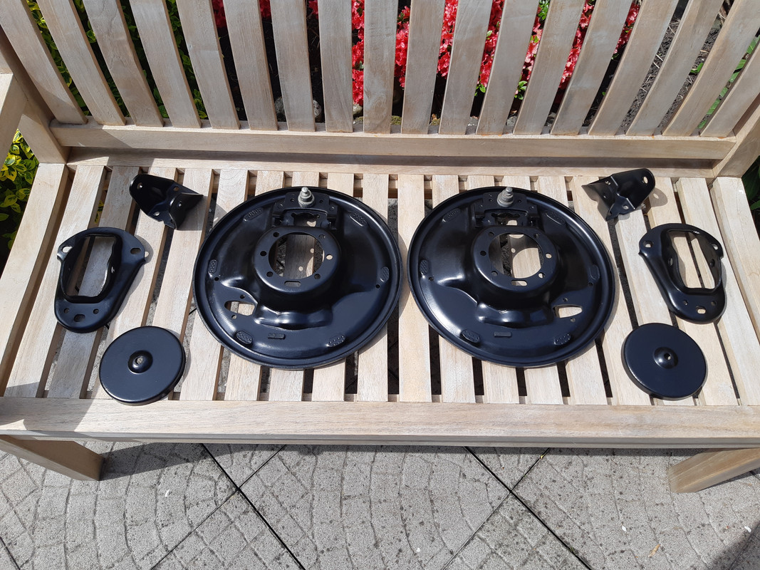

At this very moment me and my son are rebuilding the complete rear end of my 1959, what also started because of leaking axle seals. The Pinion seal also already leaked (sweat-ed) for years.

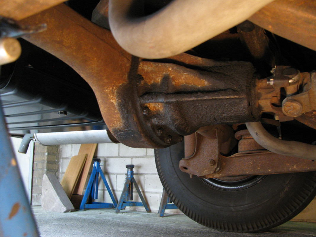

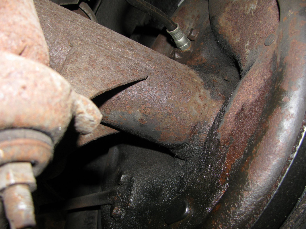

This is what a leaking axle seal will look like:

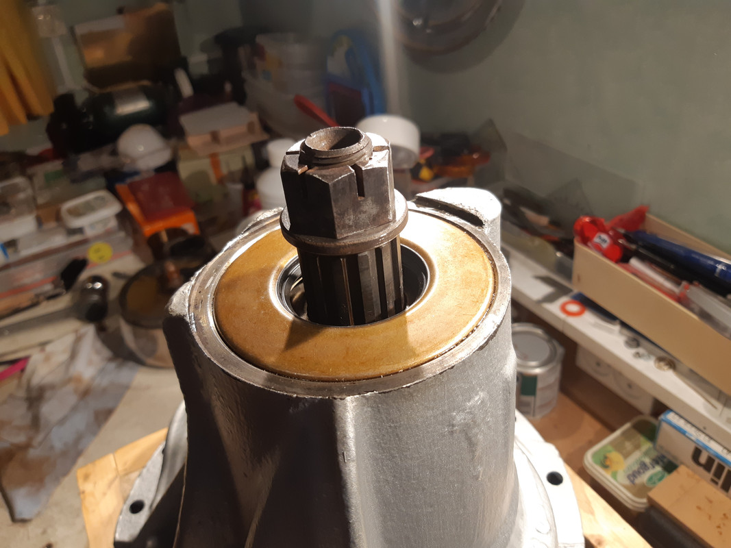

This is what a leaking pinion seal will look like:
The seals of both Pinion and rear axles were really worn.
As Bruce says, the axle seals are part of the axle bearings so you would have to replace them as a unit.
New rear axle bearings in place:
New pinion bearing in place:

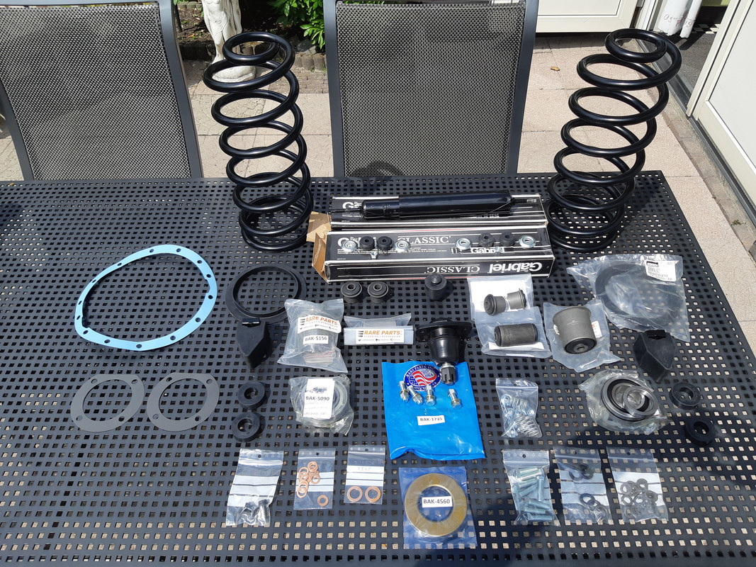

Since all the bushings, spherical joint, springs and shock absorbers were also in a bad shape, and everything was rather rusty, we decided to to it all now that we are at it.
