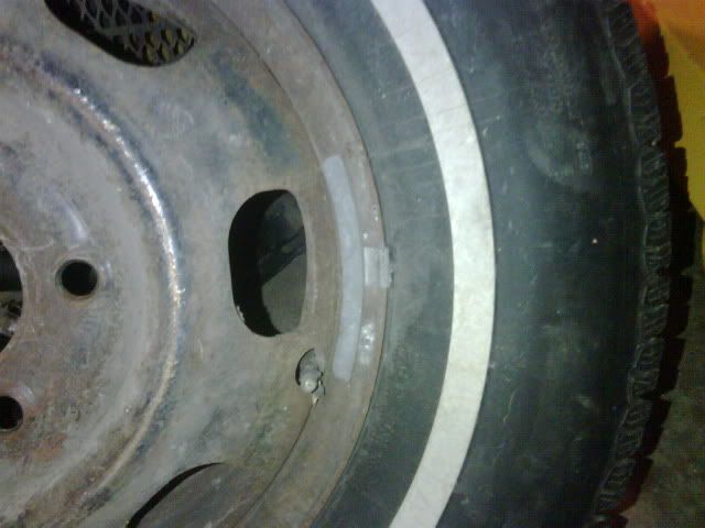

Stupid question. Are there any center caps I can put on my 78 Eldorado? The weights interfere with the hubcaps, and I am scared they will fall off. Toronado has center caps and it doesn’t look bad, but the wheels are chrome, not black. I want to drive the car, and not worry about things falling off

Have you got the correct CAX style weights?   They have a little extension on them so they don't get in the way of the cap.   I suspect they are no longer made but can still be found.   Some have apparently used the stick on weights that are common today with aluminum wheels.

Anyone know where I can get the CAX weigths as a set? The places I have looked at, I basically have to buy a lot of each weight. Would be fine if I could just buy a set that has 1 or 2 of each. I really have to get better wheels. The only wheel I have a problem with is the one thats a bit bent. Has too many weights. Other weels only have a few weights and I have space to put the caps on.

I never found any place to buy an assortment.    One option is to buy a case of the larger ones and cut them down to the weight needed.   That was going to be my plan till I found a shop that has some and was willing to sell a few.  Maybe it would be worth checking with a place like USA parts to see if they offer an assortment?
Just remember to ask for the old weights back when ever you have tire work done.
Sounds like a better wheel will help.   These cars are really sensitive to the balance on the wheels.   I have had em that balanced well on the machines but still shook on the car.   Getting a tire and rim that does not need a lot of weight to start with seems to help a lot.   I had a shop that was willing to try installing the tire differently on the rim to get the best initial balance and that seemed to help too.
